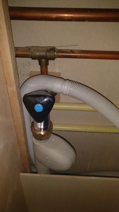

Hi Richard
I have the exact same initial problem as you (F2) on my GVW555RVS.
How did you eventually resolve the issue?
And, when you say "connector lag los aan de kant van de vlotter" can you please detail what exactly you did? Maybe it'll help me too. Currently, the back of the dishwasher is not accessible.

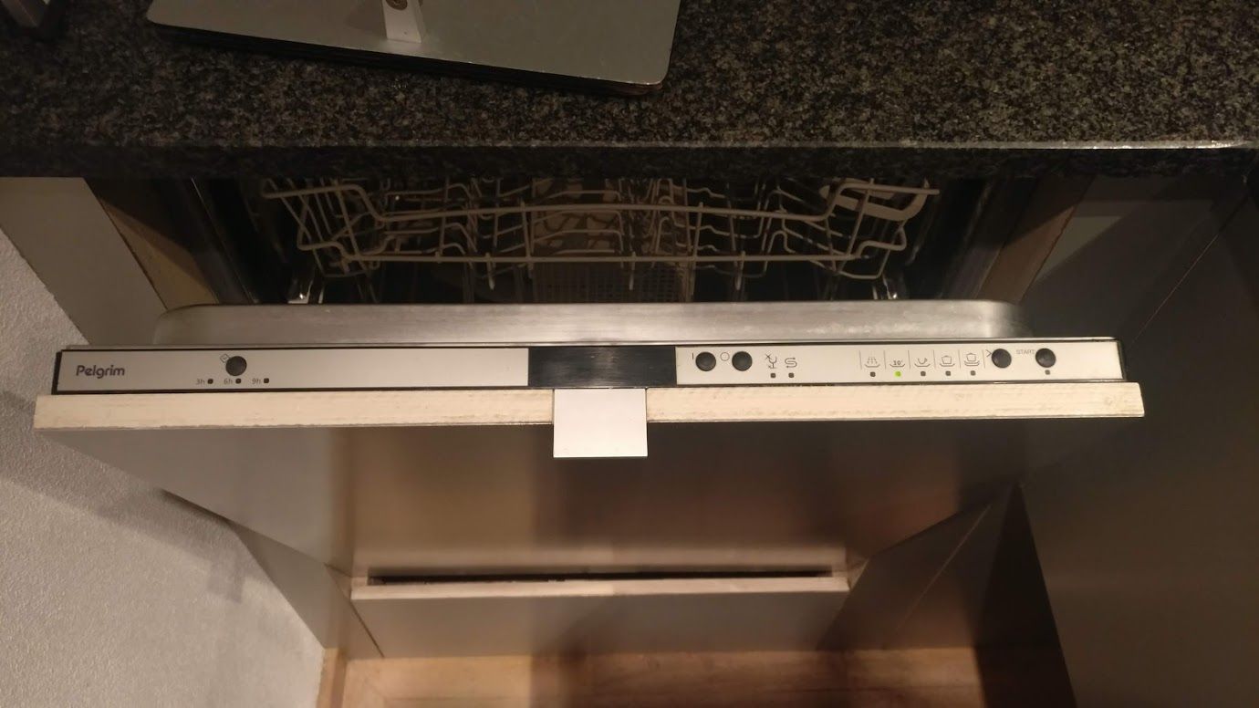

Hi Bennie,
When I close the door of the dishwasher, the water extraction is triggered: if I fill it manually with a bucket of water, it will empty it.
After the water extraction, it will make an engine sound for exactly 30 seconds. After that, it will beep: one beep per second, and two light signals in a row, from the light of the Start button.
It will not pump water inside, despite the tap being open.
When I subsequently open and close the door, it will immediately beep and do nothing else.
If I reset it (2sec long press on start button, off/on, go through cycles 0/3h/6h/9h and a cycle over the 5 programs), and restart it, it will again start the behvior from the beginning: water extraction, 30 sec of engine noise, then beep and light flashing twice in a row.

I think you have a leak in the container under the dishwasher.
This contains the pumps, heating and other electronics.
Take off the plinth at the bottom of the front and look as if there is water underneath.
Here you have a video to give you an idea.
